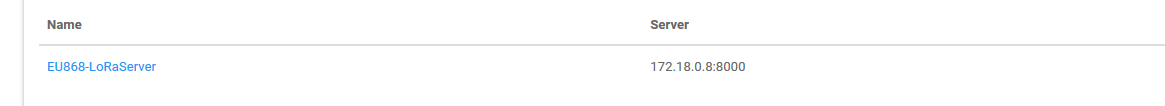

Did you update the network-server entry in LoRa App Server?
That’s the new IP with the same name.
