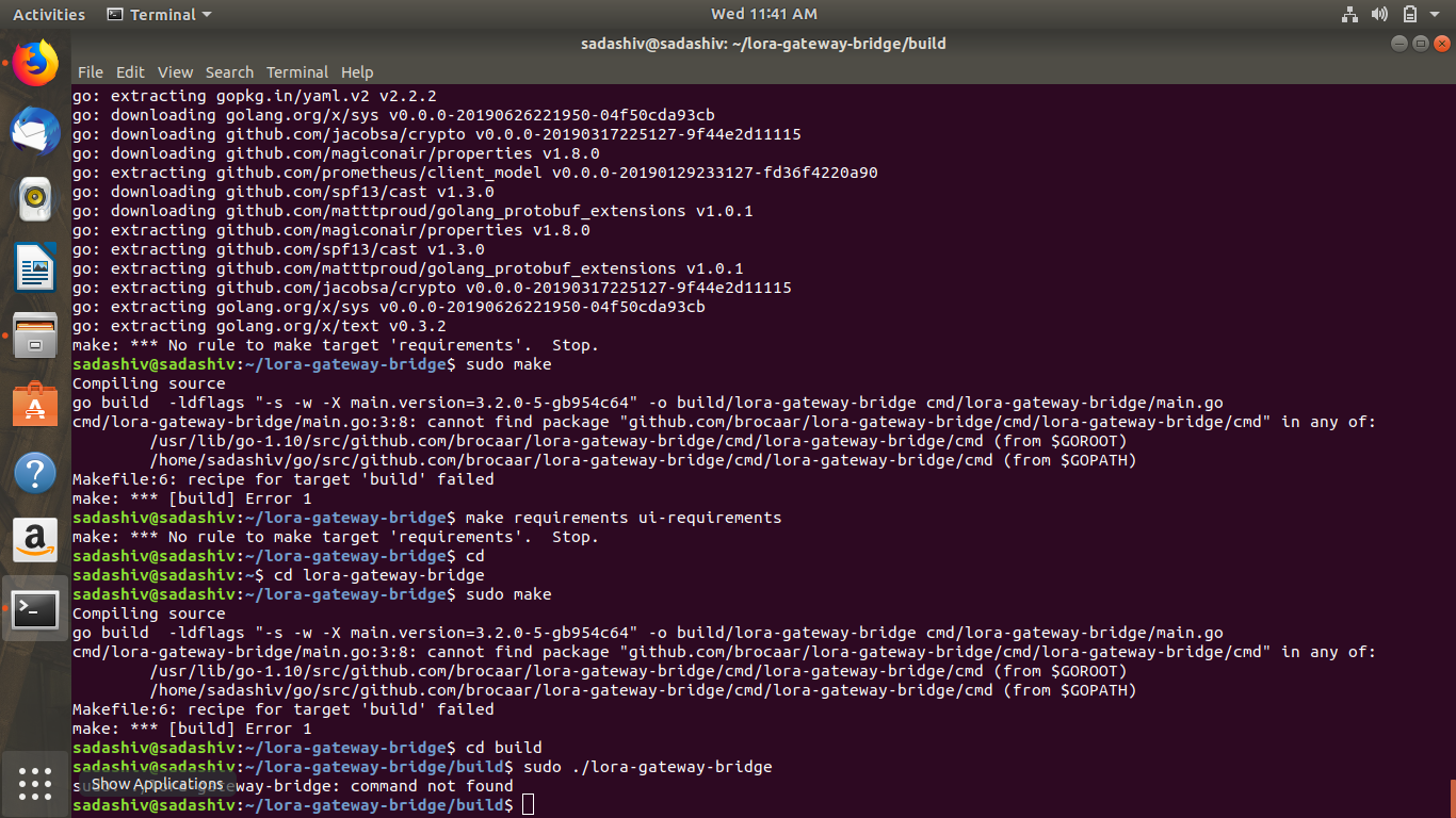

Hi Sir,
I am also working on LoRa Server I followed your process of cloning files from github.when I execute command SUDO MAKE it gives an error attached below.! pic a Screenshot%20from%202019-08-21%2011-36-48|690x68
@shuangcai_huang and @brocaar
please help me in debugging this
As i am beginner as well as a fresher i need some help in debugging this. I also did make requirements ui-requirements it didn’t worked for me as in pic b
Anyone’s help can make me up confident.
Thankyou.
You ask about LoRa Server, show a screenshot about LoRa Gateway Bridge and post this in the LoRa App Server topic
Please use correct topic the next time!
Anyway, please use the provided Docker environment for compiling. It provides you with a pre-setup development environment. See for LoRa App Server https://www.loraserver.io/lora-app-server/community/source/. For the other components you will find the same document, the commands might be slightly different.
