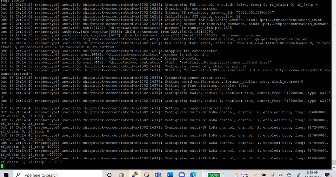

@brocaar last messages sent before the gateway just stops:
It deactivates at many given points. Seemingly random:
