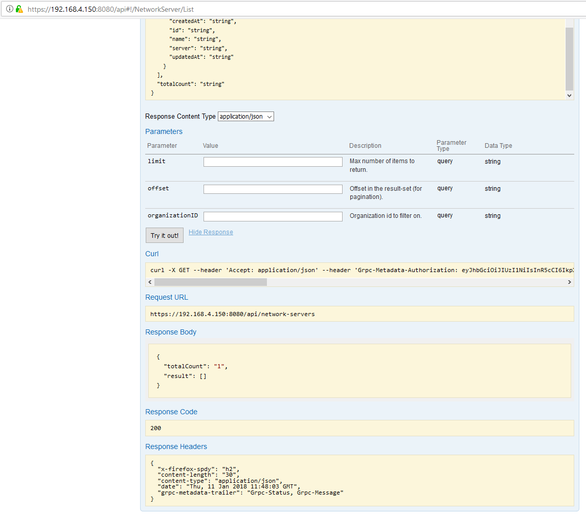

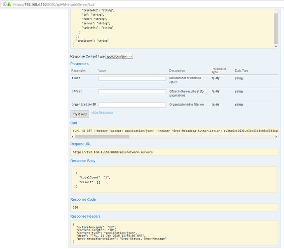

I have tired with webui API console too.JWT token is pasted at the top left corner text box.
But the api/network-servers results same as console.
“totalCount”:“1”,
“result”:[]
Attached screen shot for your reference.
I think I need to pass some value in “limit” parameter
Yes … its worked with limit value
