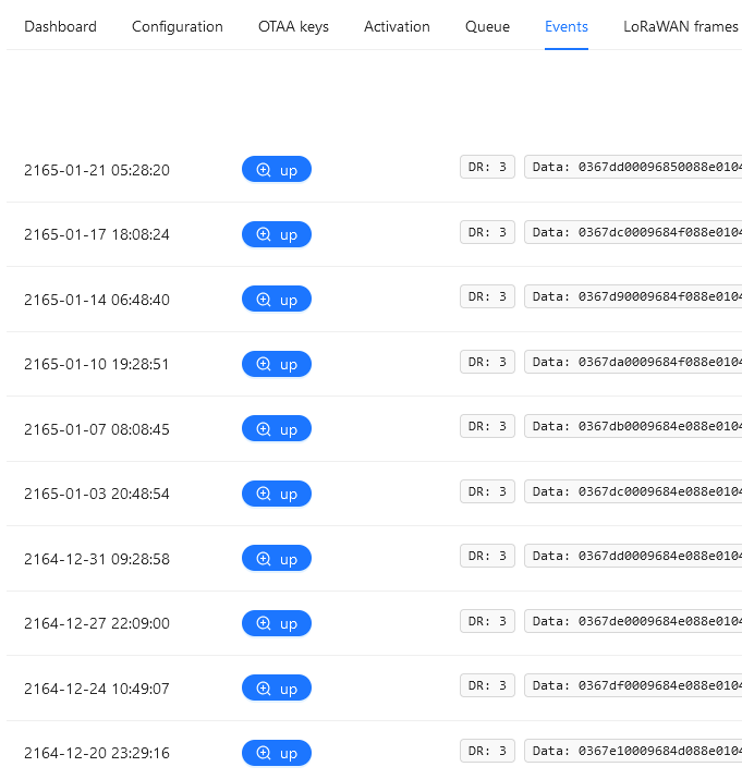

I have this interesting issue using ChirpStack v4. I recently purchased a LoRaWAN Thermostat (Milesight WT201) that doesn’t have batteries, therefore when power is lost it loses its time and causes havoc to my schedules. This wouldn’t be a problem because the thermostat should be receiving time information from ChirpStack upon joining, but it receives the wrong time.
I need some help figuring out what I can look for to fix these issues, this is our first device where time matters.
Device Events Page:
rxInfo in the payload:

The problem was related to our gateway, It was configured to send GPS timestamp but for some reason was not, I made a change to disable GPS timestamp and enable UTC Timestamp then after gateway reboot started receiving accurate time sync to devices and “Events” page.
