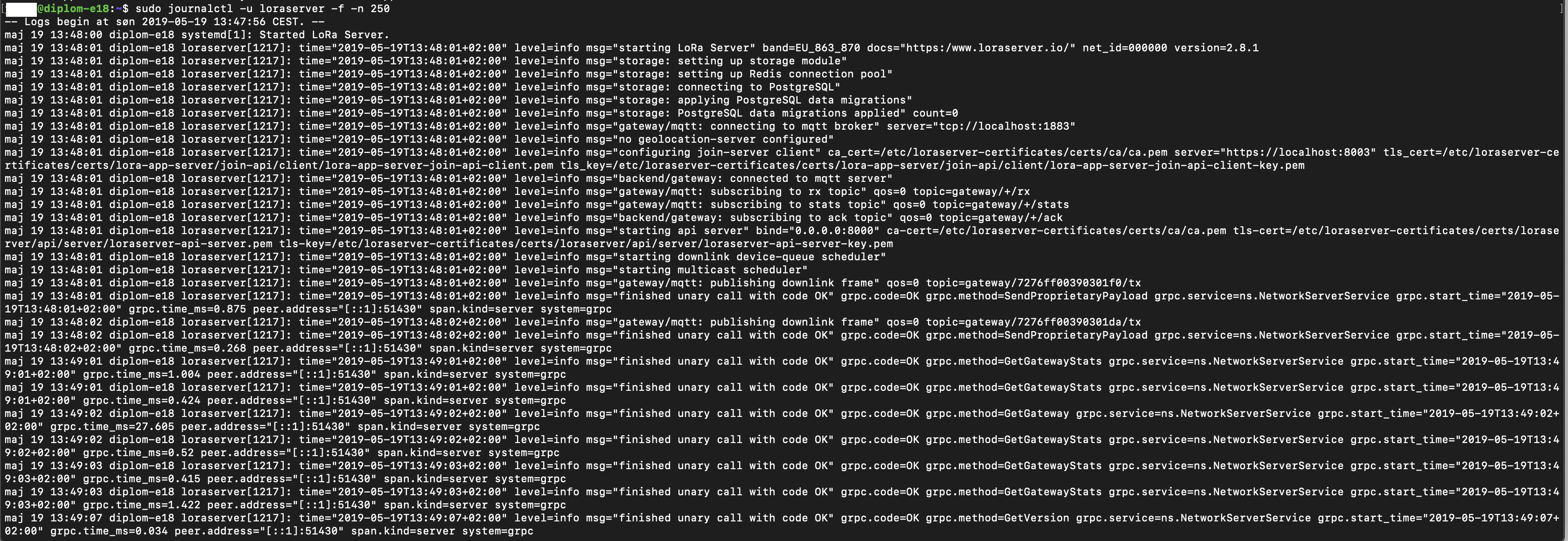

LOGS:
  • sudo systemctl status loraserver
  • sudo systemctl status lora-app-server (error and warning occurs when i try to change localhost:8000 to loraserver:8000)
  • sudo journalctl -u loraserver -f -n 250
  • sudo journalctl -u lora-app-server -f -n 250
