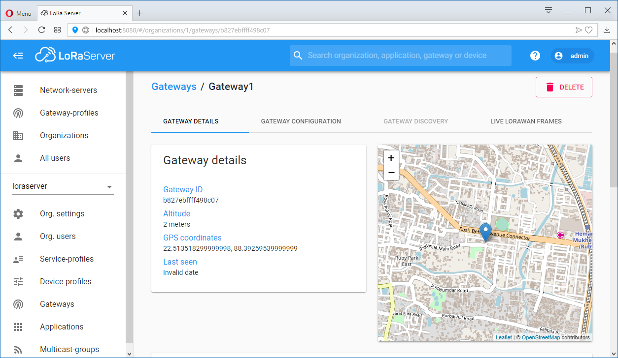

We are trying to create an instance of the LoRa Server on Windows 10 and are encountering an error while trying to add the first gateway on the App Server: the ‘Last Seen’ continues to show ‘Invalid Date’ which likely indicates that the App Server thinks the communication with the Gateway hasn’t happened yet. Please refer to the following screenshot:
But we can see that the Gateway Bridge is continuously exchanging UDP packet with the Gateway.
