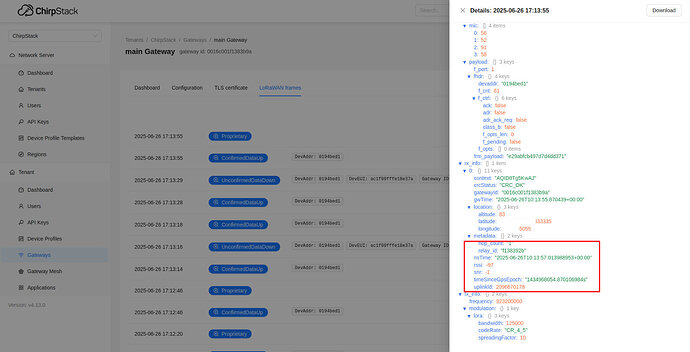

I have small problem now. I selected the “Ignore direct uplinks” to test the Relay gateway, but I still see uplinks on the Border gateway. How I can test it indoors, I have all my nodes and test GWs in one room…

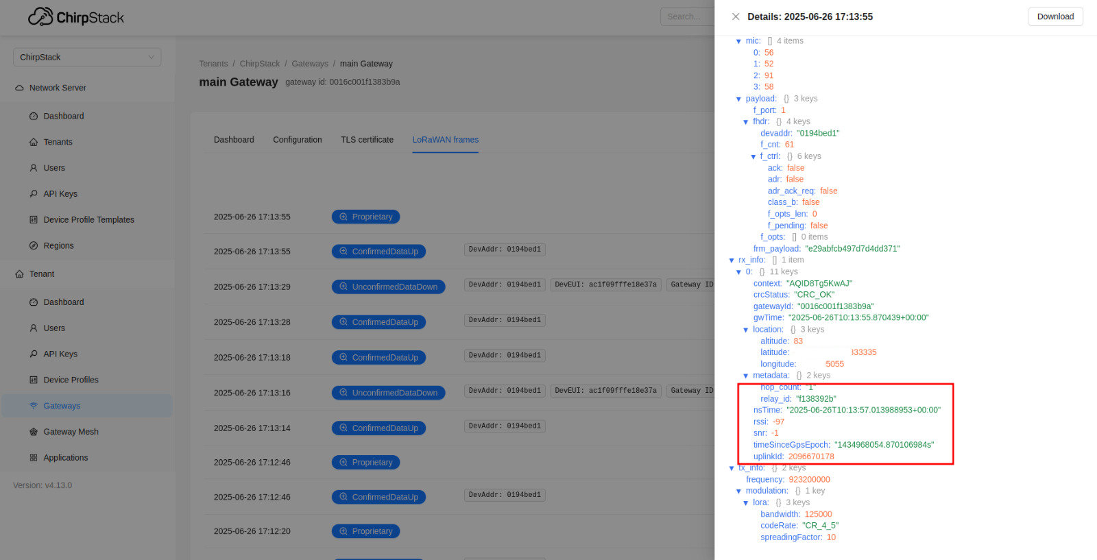

Did you check the uplink in the Events tab for the device? If it is a relayed packet, you’ll see your Relay Gateway ID in the metadata for the border gateway
Many thanks @John_A
I can see the relay ID in some of the uplinks, while others are from the Border gateway itself (without relay). So "Ignore direct uplinks” did not quite work in my case. But I can survive with that, as long I can distinguish the relay uplink from the decoded data itself.

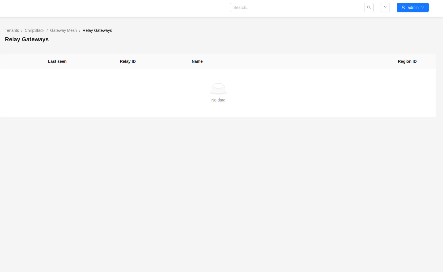

Hello @John_A @bconway @brocaar @sergi_jini @Liam_Philipp @Hitesh_Rohila
I’m testing ChirpStack Gateway Mesh using two RAK7289 gateways (AS923 region). One acts as the Border Gateway, the other as the Relay.
The problem is: the Relay Gateway does not show up in the Gateway Mesh tab on the Web UI, even though the relay_id appears in the uplink metadata.
I’ve already:
  • Set the same signing_key on both gateways.
  • Synchronized the system time on both devices using sync with browser
but the Relay still doesn’t appear in the UI.
Is there anything else I should check or configure?
If anyone could share a working or complete example configuration, that would be very helpful.
Thank you!
