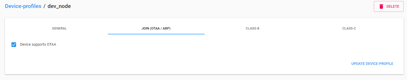

In the newest version the Application Key is in the exact same place, just under the Keys (OTAA)
tab for device (given its device profile is indeed OTAA and not ABP activated).

I can’t see this field:
KEYS (OTAA)
field is empty!
