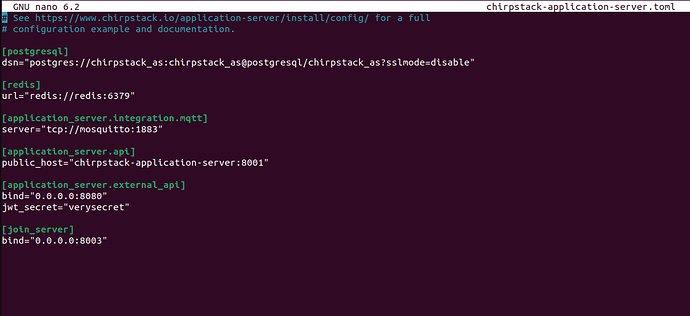

The issue you are having have just happened to me a couple of weeks ago. As far as Brocaar suggests, it seems to me that the NS is not being able to report status correctly to the AS.
In Public host configuration you should write “chirpstack-application-server:8001”.
I left here a screenshot of my Chirpstack-application-server.toml file, just in case it helps you.

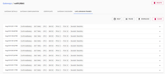

But how is it possible to see the live lorawan frames and the gateway is in the status “Never seen”?

I changed the configuration file as Nicolas proposed then start & restart the docker compose.
Save & resave the network server in the UI and it worked.
