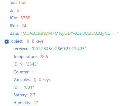

Are you certain that the javascript you supplied in the device profile runs and also gives expected output when fed “raw” data from the Device Data tab?
(example of what you’re looking for; this is for my sensor)
