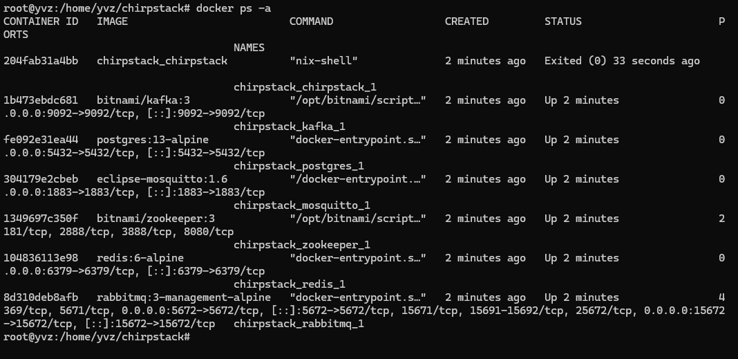

When checking the container status, I notice that the ChirpStack container stops after a while. I couldn’t find any clear error messages in the logs, but I might be missing something due to my limited experience with debugging Docker issues.

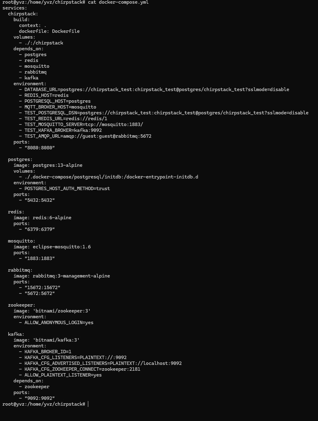

Looking at the services (e.g. kafka, …) I think you are running the docker-compose.yml from the chirpstack repo and not the chirpstack-docker repo.You should use the latter.
I uploaded the Docker Compose file. Could you please explain this in more detail? What do I need to change?
You are looking at the wrong docker-compose, please see:
