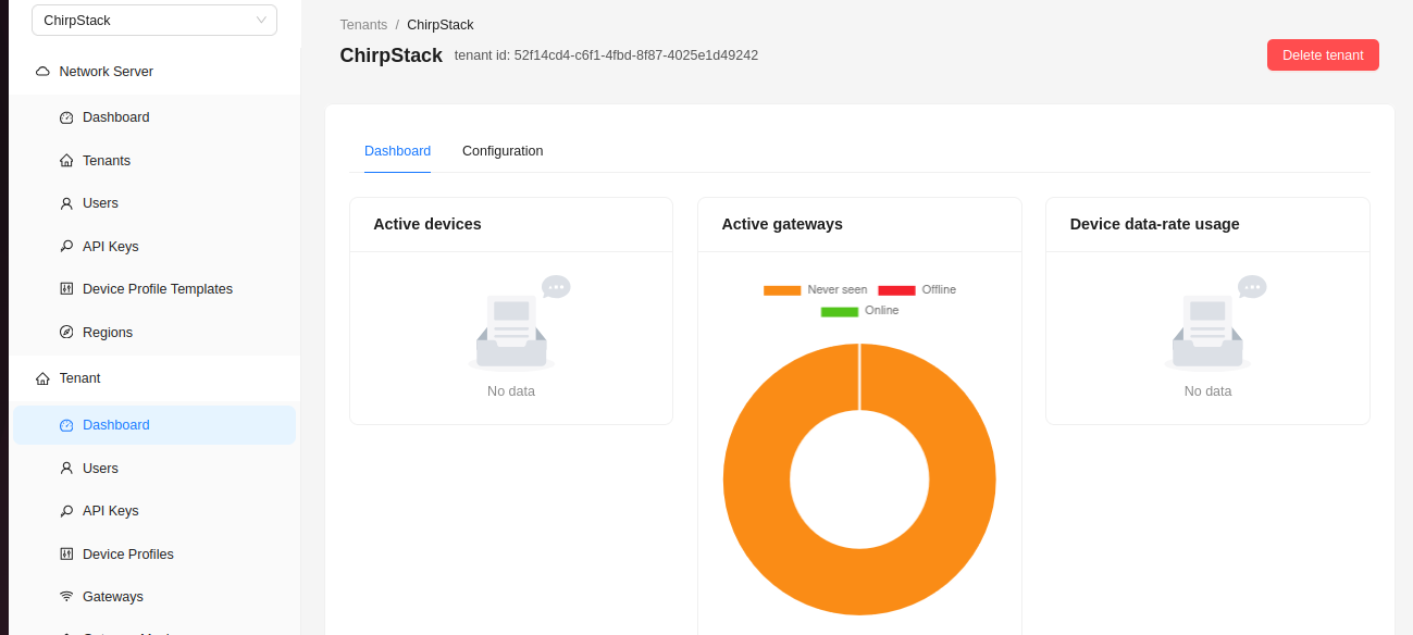

Hi Mohan, I’m bit new to chirpstack. Could you tell me how should i configure the concentrator and mqtt forwarder correctly so that i can receive packets from end nodes to gateway and see them in chirpstack application server?
It received a few packets in the beginning but (i don’t know if its because i changed the udp forwarder server) later it stopped receiving.
Currently my gateway status is shown as “never seen” (i reinstalled the OS).

Those are enabled. But the chirpstack server is still showing gateway as “never seen”.
Do you think it has anything to do with the UDP packet forwarder?
