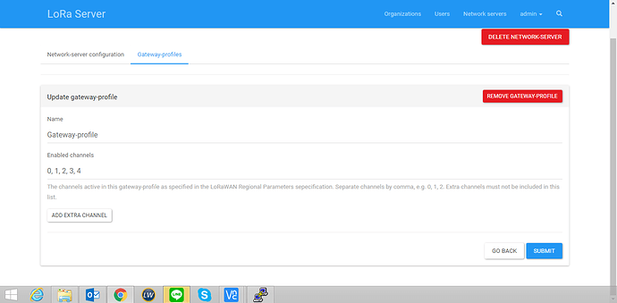

Could you please tell me how should I setting gateway on single channel gateway and setting gateway on loraserver?

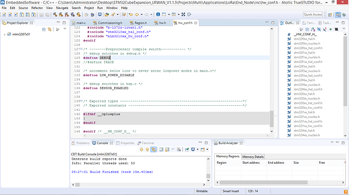

Thank you for your advice. I already enable debug mode in STM32 in my end node.
My program for develop STM32-LoRA.

This picture show LoRA server received information from raspberry pi.
