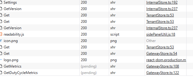

Console log from the Kubernetes version I removed a lot just to keep it somewhat short
background-redux-new.js:1 Uncaught (in promise) Error: No tab with id: 2026259967.
/#/tenants/d24dd5c4-614c-4935-9c05-54ee7d6d19a1/gateways/647fdafffe0117df:1 Error handling response: TypeError: Cannot read properties of undefined (reading 'isCheckout')
    at chrome-extension://clmkdohmabikagpnhjmgacbclihgmdje/content-script.js:1:5713
/#/tenants/d24dd5c4-614c-4935-9c05-54ee7d6d19a1/gateways/647fdafffe0117df:1 Unchecked runtime.lastError: A listener indicated an asynchronous response by returning true, but the message channel closed before a response was received
DeviceStore.ts:191
           POST https://motmod/api.DeviceService/GetLinkMetrics 504 (Gateway Timeout)

helpers.ts:7 API error:  U {message: 'no authorization provided', stack: 'Error: no authorization provided\n    at new U (htt…motmod/assets/index-CLIOoR6L.js:533:16235)', code: 16, metadata: {…}}
GatewayStore.ts:108
           POST https://motmod/api.GatewayService/GetMetrics 504 (Gateway Timeout)

helpers.ts:7 API error:  U {message: 'Unknown Content-type received.', stack: 'Error: Unknown Content-type received.\n    at new U…motmod/assets/index-CLIOoR6L.js:533:16235)', code: 2, metadata: {…}}
GatewayStore.ts:122
           POST https://motmod/api.GatewayService/GetDutyCycleMetrics 504 (Gateway Timeout)

Hello, still trying to figure out what’s going on, wish someone else had also deployed this to Kubernetes :slight_smile:
Anyway, the update is that I can do some GRPC commands, but not all. Below are the commands I tried and the output, or “lack thereof”.
The image is from the browser console showing calls that work and ones that are always (pending).
gRPCurl TEst Commands
These command were done with kubectl port-forward command so I could just bypass the LB. Some work, some hang… sanitized.

GatewayService/GetDutyCycleMetrics (Does not return - hangs)
grpcurl -plaintext \
  -proto api/proto/api/gateway.proto \
  -import-path api/proto/ \
  -H "Authorization: Bearer <TOKEN>." \
  -d '{"gateway_id": "<GATEWAY_ID>","start": "<START>","end": "<END>"}' \
  localhost:8885 api.GatewayService/GetDutyCycleMetrics
GatewayService/GetMetrics (Does not return - hangs)
  -d '{"gatewayId": "<GATEWAY_ID>","start": "<START>","end": "<END>"}' \
  localhost:8885 api.GatewayService/GetMetrics
