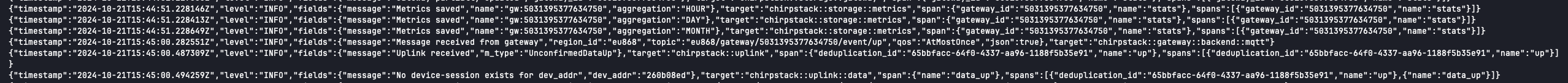

Logs
Chirpstack Logs
Chirpstack Gateway Bridge Logs
I would be very grateful for any help. If additional information is needed, I can provide it. Thanks

Thanks for pointing out the error. I fixed it, but the issue is still happening. In the “Events”, I keep seeing “join” requests with different device addresses. The only change is that now I am getting the data transfer type “tx_ack”. Do you know what might be the issue?
chirpstack logs:
chirpstack-gateway-bridge logs:
Here’s what I’m getting from the gateway in Winbox:
I’m finally receiving uplink messages. In my case, the issue wasn’t with the devices or ChirpStack! The problem was that the gateway network (in Winbox) was set to private instead of public. Once I changed that, the issue was resolved. I’m sharing my current configuration below in case it helps someone else.
