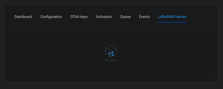

Thank you Liam , this was super helpful, so as of now if Redis state is lost, it is not a big deal right? also where are the LoRaWAN frames state kept, this is not in redis or postgres… as I have restored both and nothing shows up here
anyone knows where the frames are kept that are shown in the chirpstack interface?

@thebadking: The LoRaWAN frames / events shown in the web-interface are stored in Redis.
