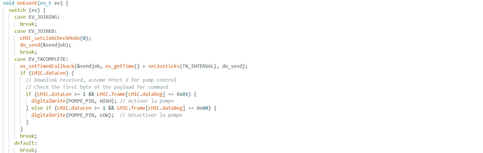

- I also tested enqueuing a downlink manually from the ChirpStack web interface (FPort = 1, HEX payload
01). - In my LMIC code, I check for downlinks in
EV_TXCOMPLETE:
The issue:
- The uplink is fine.
- But the downlink never reaches the device (LMIC.dataLen is always 0).
