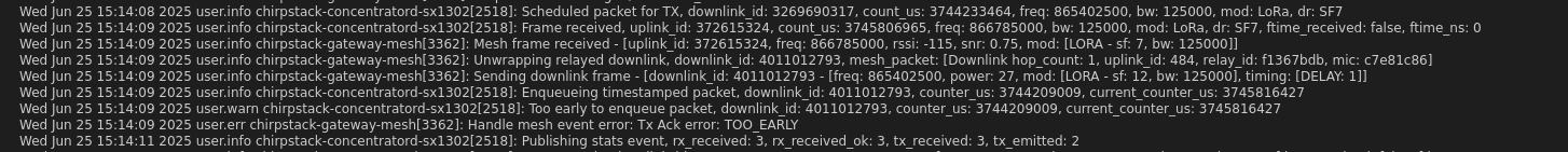

Primary Issue – Downlink Failure
When initiating manual downlinks from ChirpStack LNS:
  • Border gateway receives and forwards the downlink
  • Relay gateway fails to transmit it
  • Logs return:
    Handle mesh event error: TX Ack error: TOO_EARLY
