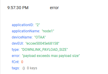

In the previous test, I tried to send one byte of data on the application server, and the results were all successful, but today the following problems suddenly appeared:

The error occurs in application-device data interface:
Please help me, I don’t know why about it

I am trying to understand this issue as well. For DR_3 in US915, I expect a payload size of 242 bytes each way, but chirpstack is limiting the downlink to 53 bytes. I can uplink 242, and my lorawan stack tells me the max payload is 242, but chirpstack blocks my downlink data for any size over 53. Is there any other setting that I am not seeing to control this?
