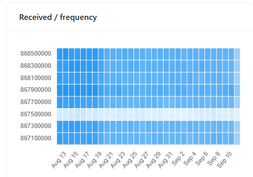

My Chirpstack system consists of several thousand devices, all located in the EU region. At only one location, I have devices that transmit very poorly on one frequency (867.5). The reason for this is that it is a train station with many shops and technical systems. The frequency appears to be congested.
It’s good to see that the gateway at this location only receives a few packets on this frequency:
frequency map:
120 to approx. 850 per frequency.
