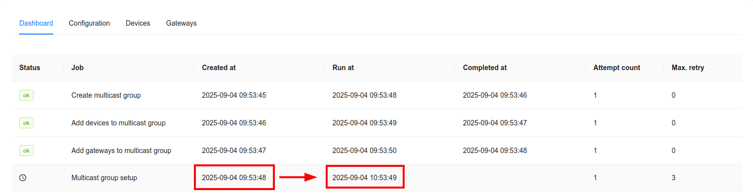

I had a problme when i test fuota on my devices, after Add gateways to multicast group it’s successful, it is noted that the next job will take place in 1 hour.
Whats happen, Is there a parameter to configure that ?

I believe the Multicast group setup speed would be based on the expected uplink interval of your device. If in your device profile you left the expected uplink interval at 3600 seconds (1 hour) I think this would cause this step to take 1 hour.
Because the system has to wait for each of the devices to report in so it can send the Multicast Group Setup request (fport 200) to each device and the only way to get all devices is to wait for their uplink interval to pass. You could try modifying the expected uplink interval in the device profile you are attempting to update and see if that affects your timing here.
