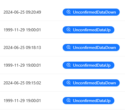

When I enable my gps on WM1302 and push data to the network server I notice the timestamps of the received packets are dated incorrectly as 1999…Can someone point me to what is wrong?

Even more concerning that the fact that the year is 1999 is the fact that the date and hour is static in all Uplink
