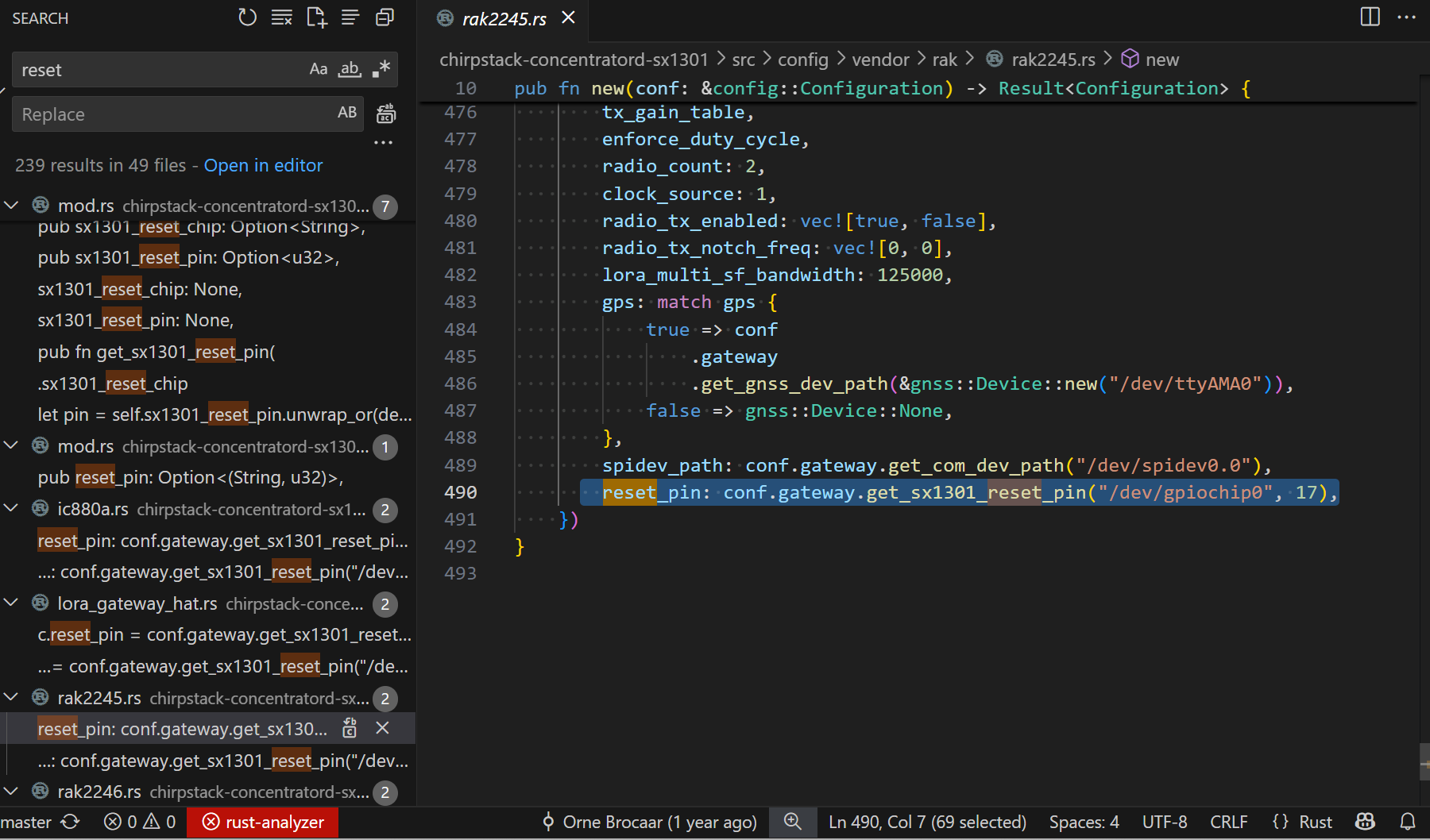

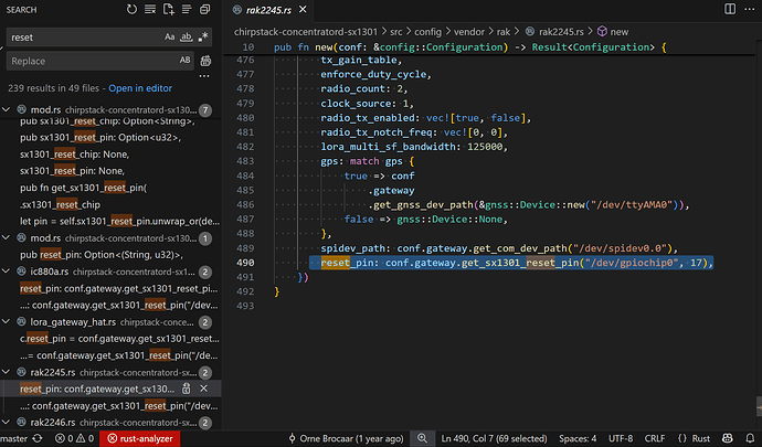

I believe it is supposed to use GPIO 25 as reset.
Is there a way to change it from 17 to 25?

I have the same need for my RisingHF RHF0M301 too.

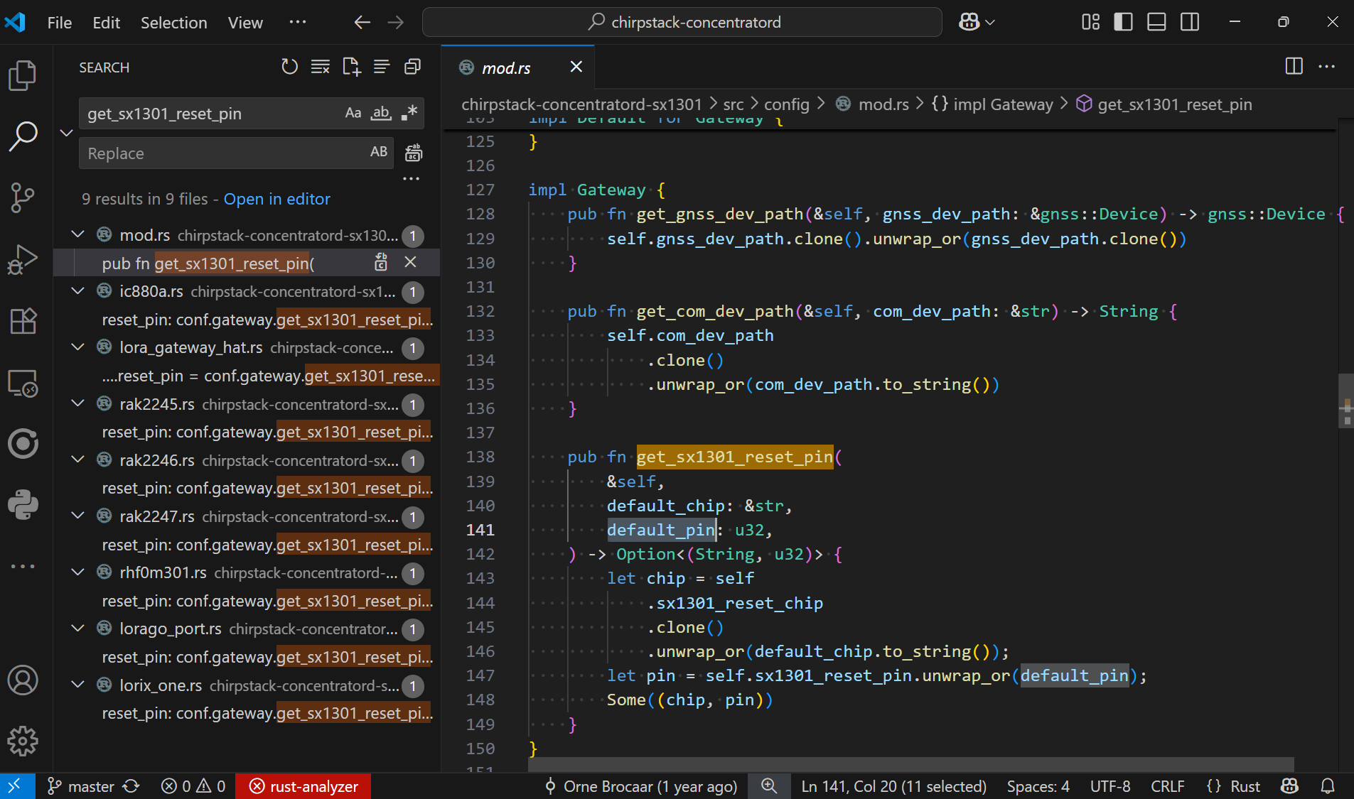

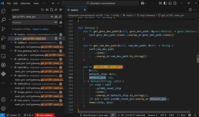

This is in the code
It seems the code fails to get the RESET pin from the board, then it uses the default port 17.
