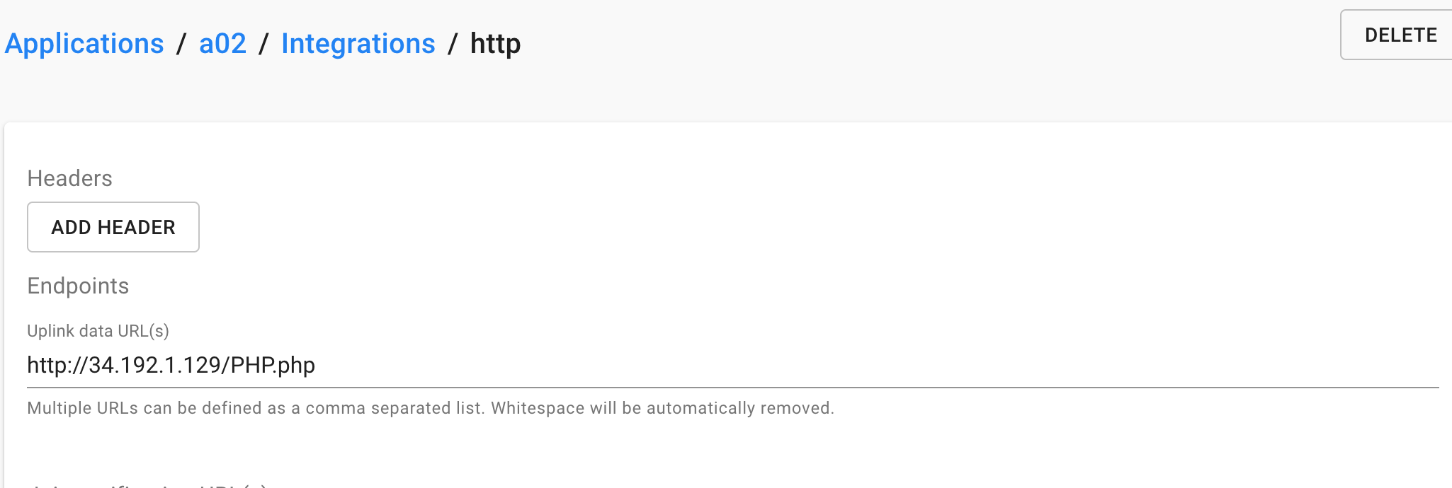

I decoded data in LORA frame and got data from it using custom JS code.I want to implement application to read this data. When I selected application, i get
I then select HTTP integration and enter uplink URL starting with http://
my script is a PHP file that outputs to a temp file. When uplink message is triggered nothing is being written to a temp file.How do I debug this?

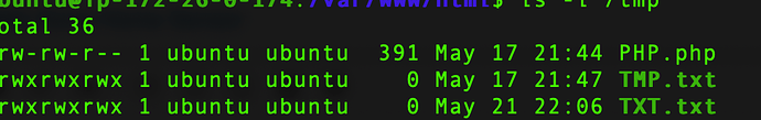

it indicated the script was running in access.log and no pertinent lines in error.log

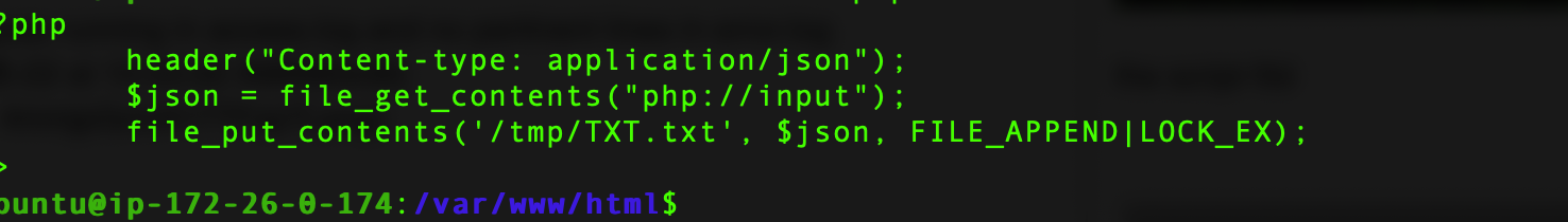

the script file is:
but the file is still empty
Does your HTTP integration points to this script? Is it accessible from browser? check the file permissions, owner/group etc.
