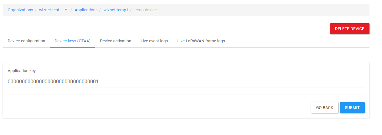

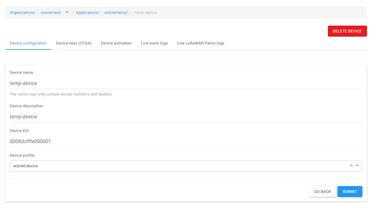

In my lora-app-server, I can just show as below page. It doesn’t have page to generate or set APPEUI and APPKEY.
The last screenshot shows the page where you enter the appkey :slight_smile: There is no need to enter the AppEUI / JoinEUI.

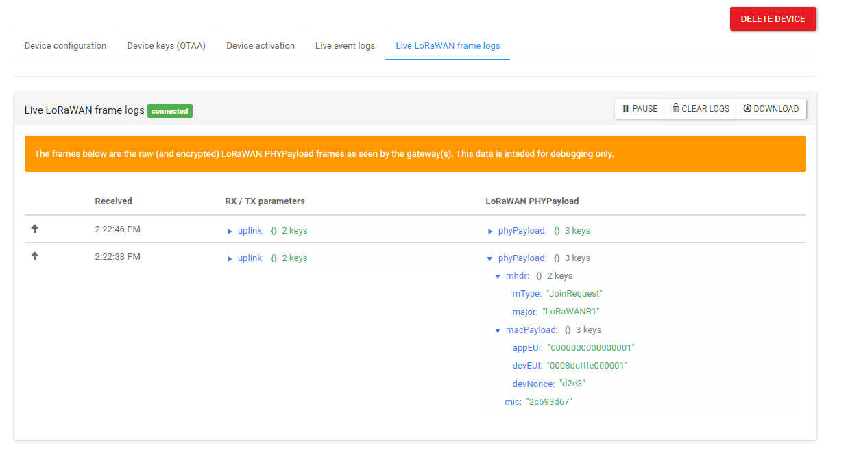

This is log in the Lora-app-server. If lora-server or lora-app-server has join-server, Is it right what I did set to device? ( I used AppEUI “0000000000000001” in my device )
In this case, Does it has problem?
