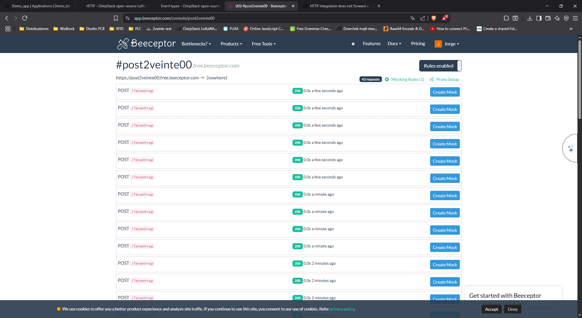

Hello @Jerome73.
i am sure chirpstack is sending events
But I still can’t receive any event.
No web server tool has been able to receive any event from ChirpStack
Can this be a problem with the firewall? first time that I am having this problem
