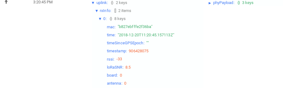

I’ve been playing with the HTTP integration recently and have managed to receive packets sent from my device. However, in the ‘rxInfo’ section of the uplink JSON, there are a number of fields that are displayed in the loraserver GUI (live frames) that do not get sent via the HTTP integration POST.
The main field that I need is the timeSinceGpsEpoch as I need an accurate timestamp for the reception of the packet at the gateway. While testing, I can see (from the live frames page) that there is a 1 second difference between the ‘time’ and ‘timeSinceGpsEpoch’ fields.
Is there an easy way to include this field? Any suggestions will be gratefully received. I’m happy to try any mods or hacks to get it going, though I have no experience with Go.

Thanks for your help. I’m not sure the issue is leap-seconds. I’m converting the timeSinceGpsEpoch value with the tool at: https://www.andrews.edu/~tzs/timeconv/timeconvert.php and it is coming out 1 second ahead of the value in ‘Time’. I guess there could be an issue there if it is an old tool. Unfortunately I’m not able to investigate further until tomorrow now.
Where is the ‘Time’ value generated? is it from the gateway timestamp or the system time when the packet is received by the forwarder?
Either way, I’m doing some time comparisons based on the beacon time, which is GPS time so it would be really helpful if there was a way to get timeSinceGpsEpoch via HTTP integration.

Thanks for the link to the tool. Not sure how to use it, but I have manually checked the values and get the same thing:
If you take the timeSinceGpsEpoch 1229340585 and add the UTC epoch offset 315964800, then subtract the 18 leap seconds, you get 1545305367 which is 2018-12-20 11:29:27 (not 11:29:26 as in the image).
Not sure where to go from here. What could be causing the difference? Is there anything I can test to debug the problem further? Or is it possible to add timeSinceGpsEpoch to the HTTP integration post data?
