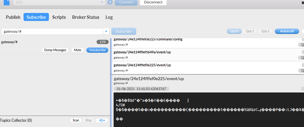

I use mqtt.fx to get data.but it error codes
i haved set the narshaler = “json” in chirpstack-gateway-bridge.toml
you are using the protobuf marshaller for the gateway-bridge/Network-server
its ok when lora wan send data to chirpstack server
double check your config. It really looks like you are using the protobuf marshaller.
i have set ’ narshaler = “json” ’ both in chirpstack-gateway-bridge.toml and chirpstack-application-server.toml. need i edit ohters ?
No. Can you provide your configuration, remember to take any sensitive information out. Use a service like gist or pastebin and put the link in here.
Not sure, but it looks like a typo, it must be marshaler, not narshaler.
i solved when i use user ‘chirp_gateway’ in lora wan and user ‘chirp_application’ in mqtt.fx.
