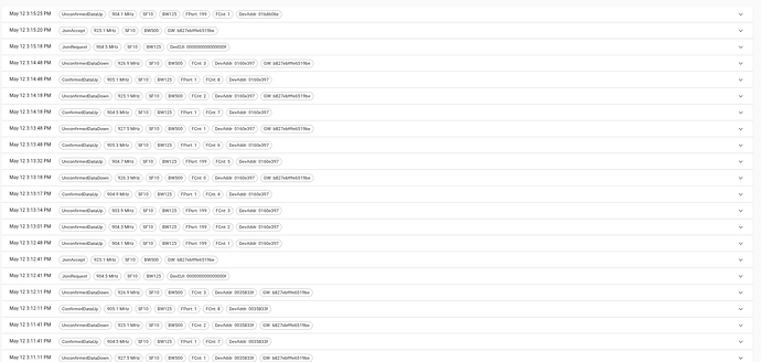

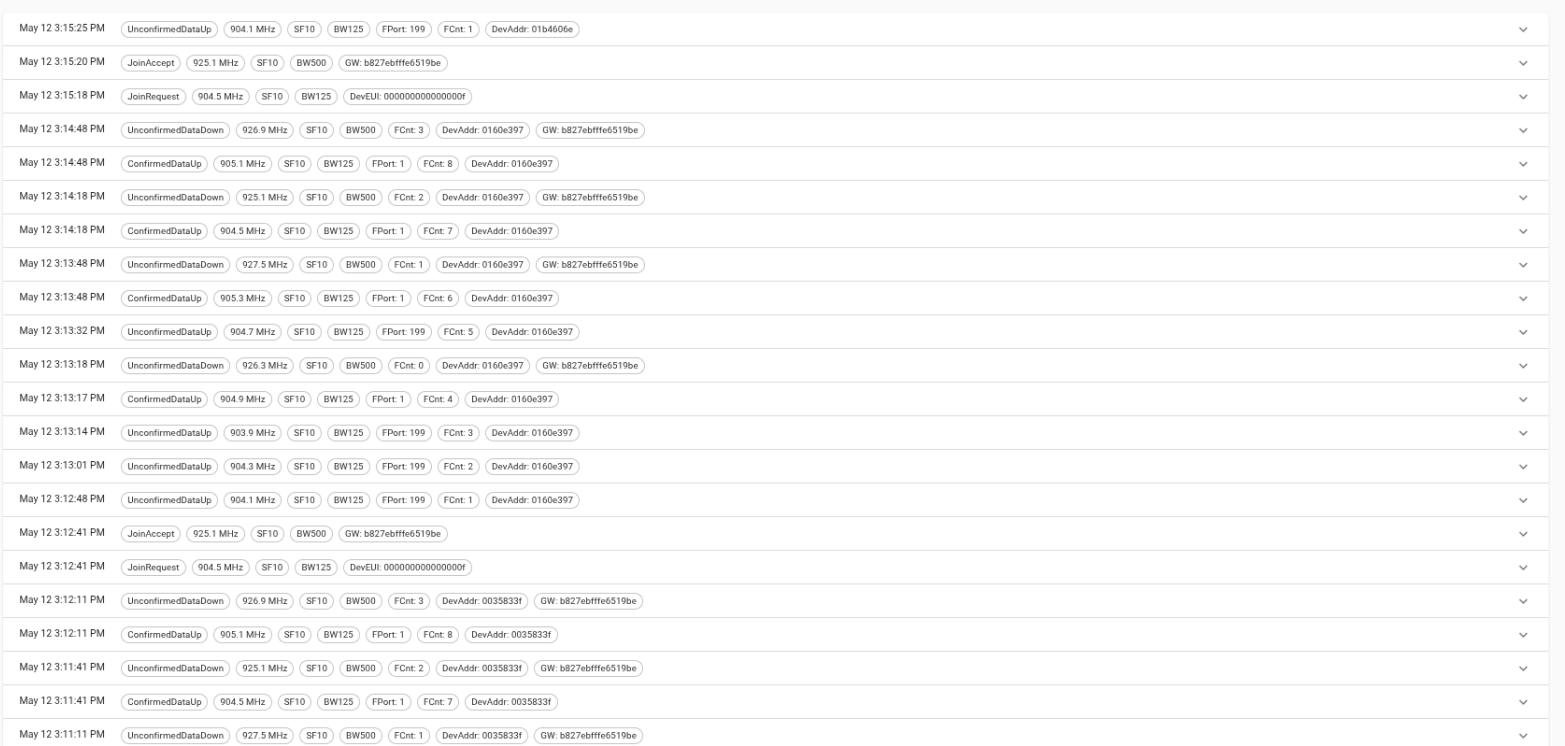

Join-Request/Join-Accept repeat
Data is received by checking in Gateway / LIVE LORAWAN FRAMES in UI.
Select Device in Applications to save
Join-Request/Join-Accept. However, only Join-Request/Join-Accept is repeated.
We will also save the data and upload it, so please help.

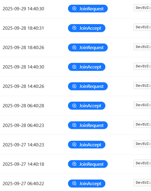

We are facing the same issue - some of the devices were working perfectly fine days before and now they are stuck in JoinRequest-JoinAccept loop. This is one of them:
We tried looking up all the possible logs, no luck - there’s pretty much the same information in the logs as in the web. But I would be glad to provide logs if anyone has any ideas how we could debug this and find the issue…
