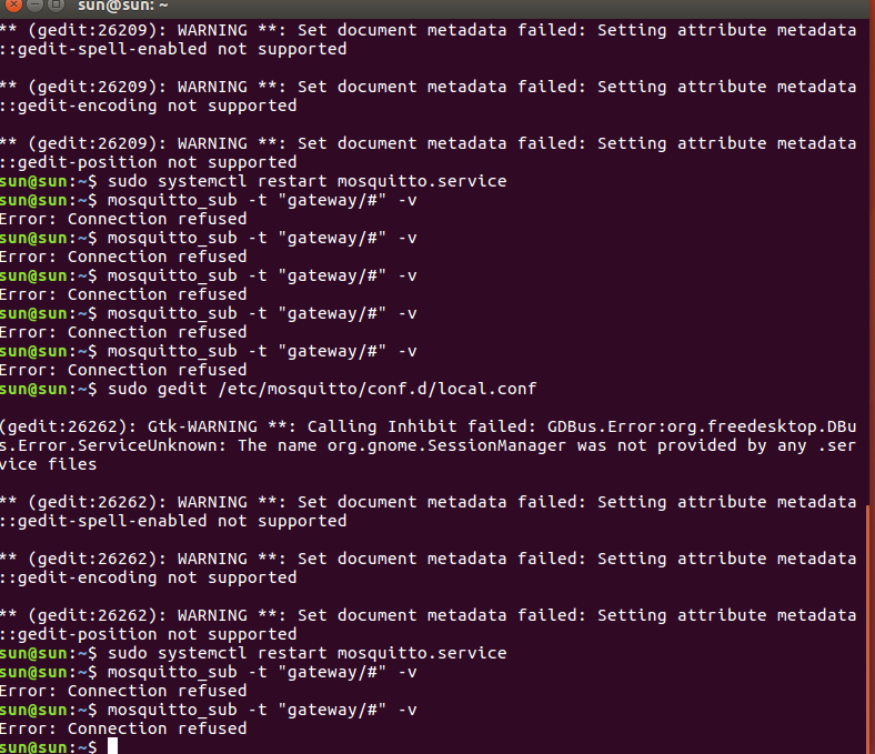

Follow the steps, but it does not work
who can help me?
thanks bro here the problem
The mosquitto_sub cli is unable to connect to your MQTT broker. Make sure:

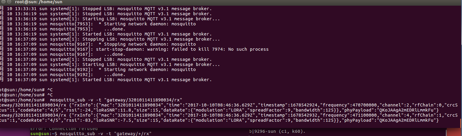

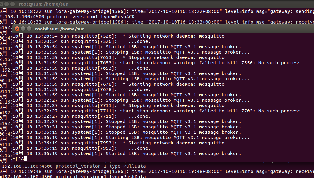

You could also inspect your Mosquitto logs. Not tested but you should be able to find them using journalctl -f -n 100 -u mosquitto or somewhere under /var/logs/mosquitto..... That might give you a clue
what is means about the logs?@brocaar
