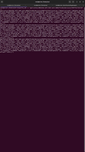

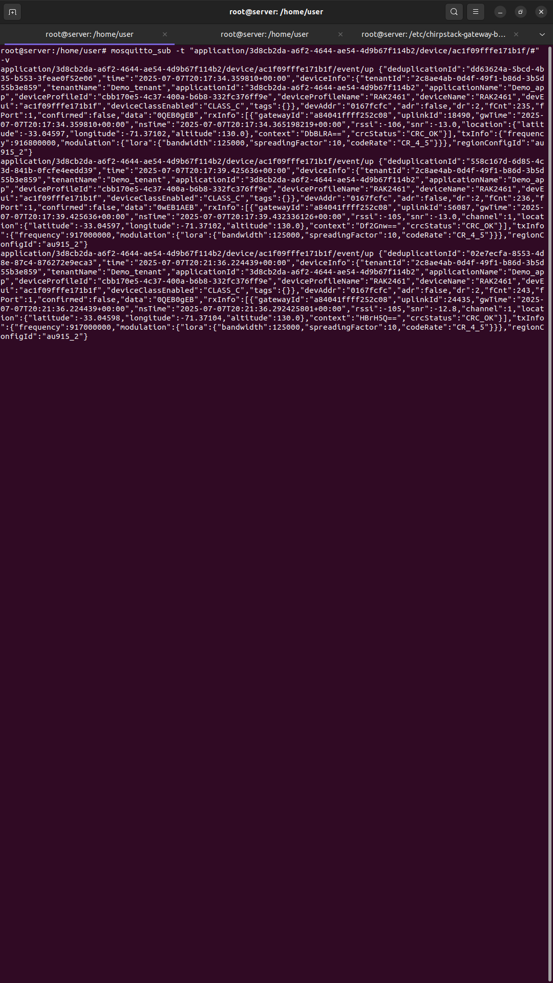

Here are the screenshots, the terminal shows the events (up and down) of the devices while I tried to send commands via the webUI:
mosquitto_sub -t “application/3d8cb2da-a6f2-4644-ae54-4d9b67f114b2/device/ac1f09fffe171b1f/#” -v
terminal output:

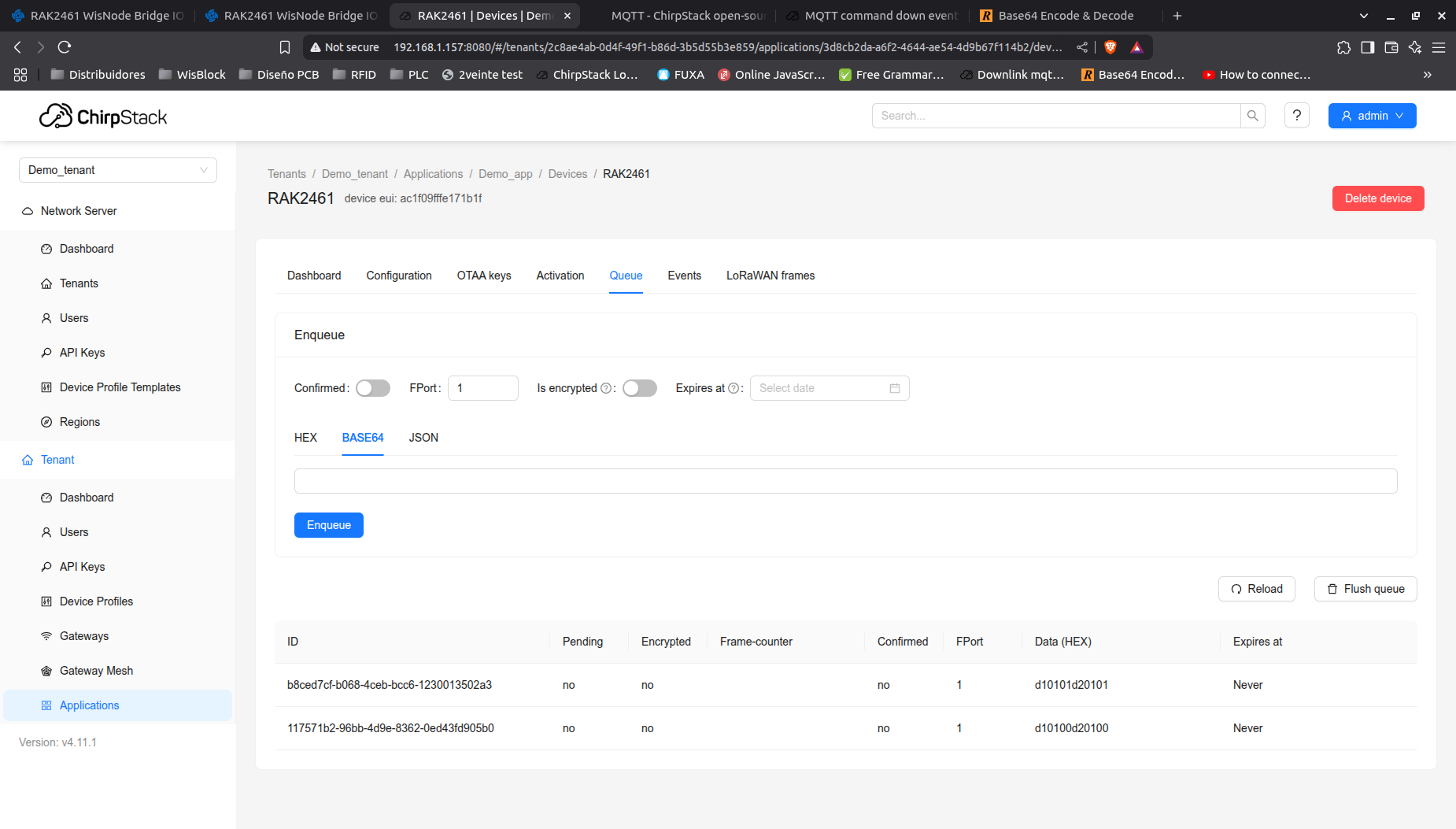

WebUI while I tried to send the same command (D10100D20100) in hex(first) and base64(last):
As you can see, there is only the up event. I’m lost on this one, any help is appreciated.

I see you have Chirpstack 4.11.1 on the screenshot, so the issue is likely due to a low redis version.
See Chirpstack 4.11 Downlinks No Longer Work - ResponseError: unknown command GETDEL - ChirpStack (v4) - ChirpStack Community Forum
