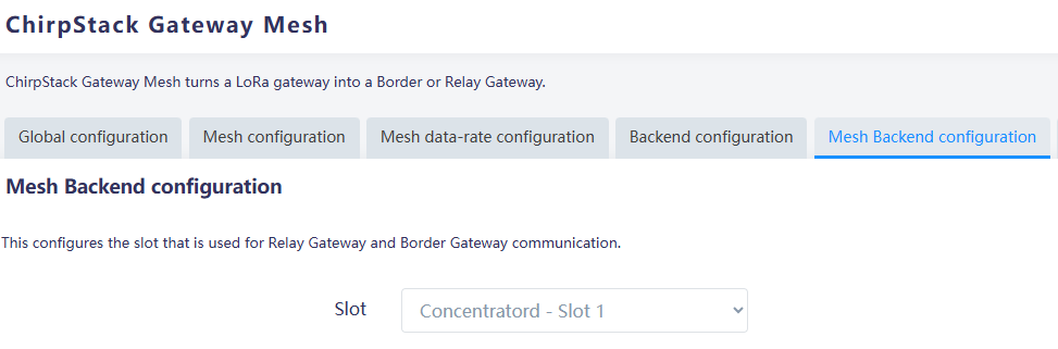

I’m trying to configure a gateway mesh setup using ChirpOS on a WisGate Edge Lite 2 (RAK7268), with the goal of forwarding data to ChirpStack.
I’m currently running ChirpOS v4.8.1, and I’ve followed both the official ChirpStack and RAK Wireless guides to configure it.
The issue is the following:
- When I enable the MQTT Forwarder under the “Slot1” tab, the gateway connects to ChirpStack and data is forwarded correctly.
- However, when I enable the MQTT Forwarder under the “Mesh” tab (to use the Gateway Mesh functionality), the gateway does not connect to ChirpStack.
I’ve double-checked the credentials and broker settings — they are the same in both cases.
I’m attaching two screenshots:
- The current configuration under the “Mesh” tab.

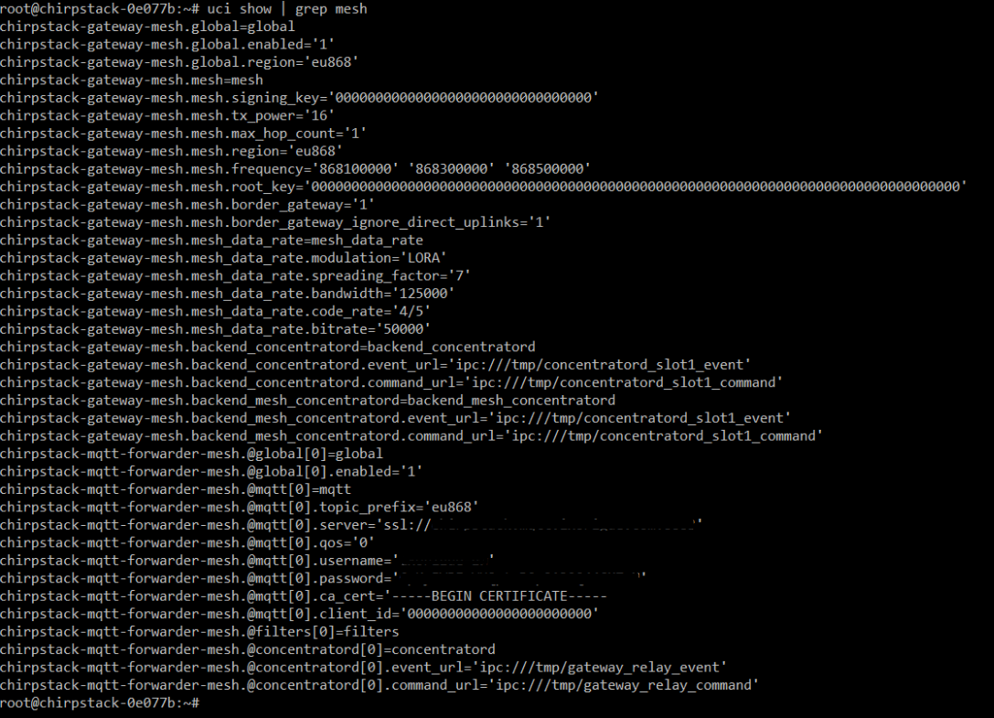

- A log snippet right after enabling the MQTT Forwarder in Mesh mode — as you can see, it gets stuck at “Reading GW ID” and does not proceed.
Is there any additional step required to make the Mesh MQTT Forwarder work? Or is this a known limitation or bug in ChirpOS?
