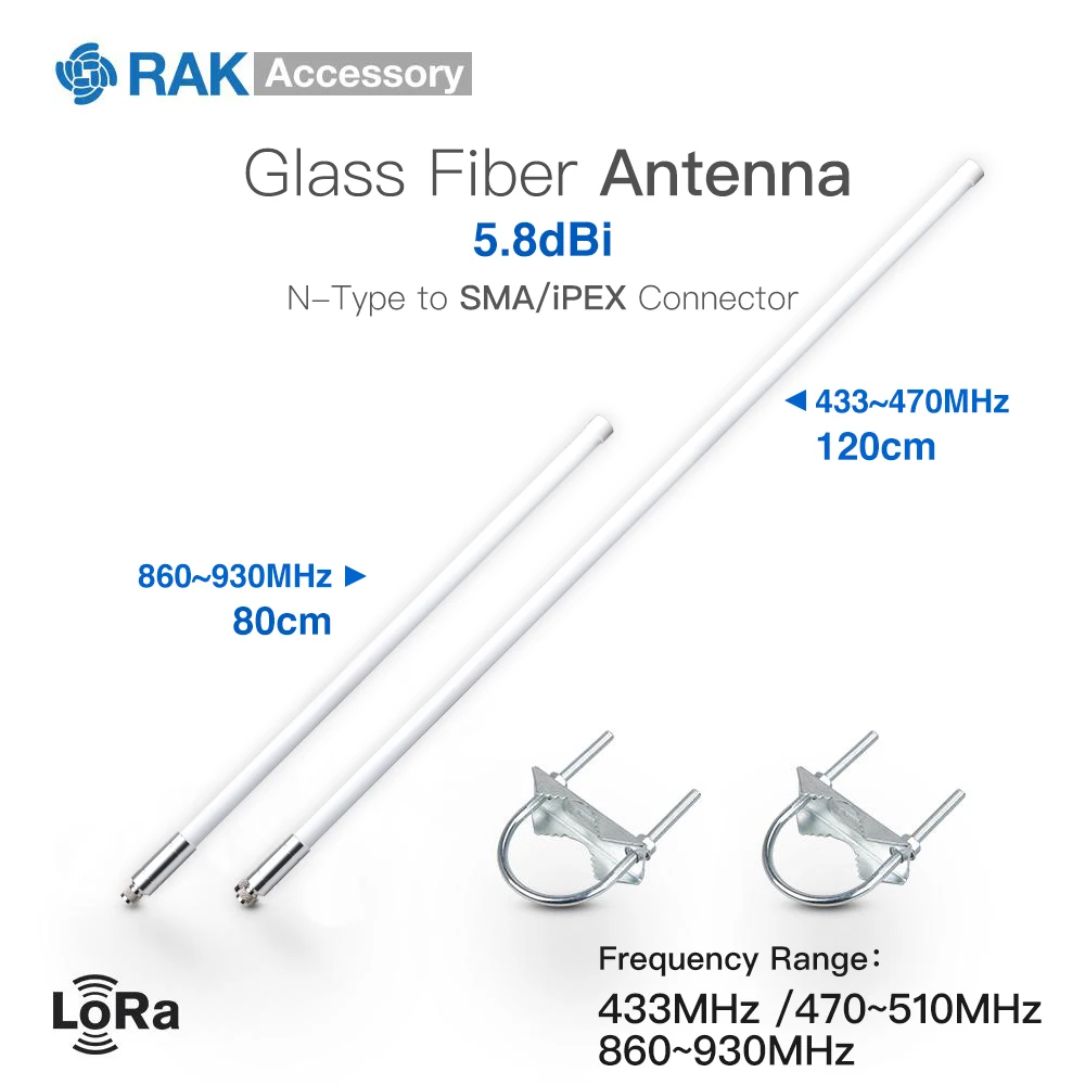

RAK AP/Gateway
I have also played with the RAK833 AP/Gateway, and works well wit the meter.
AP - US $212.50
Ant
US $27.50
