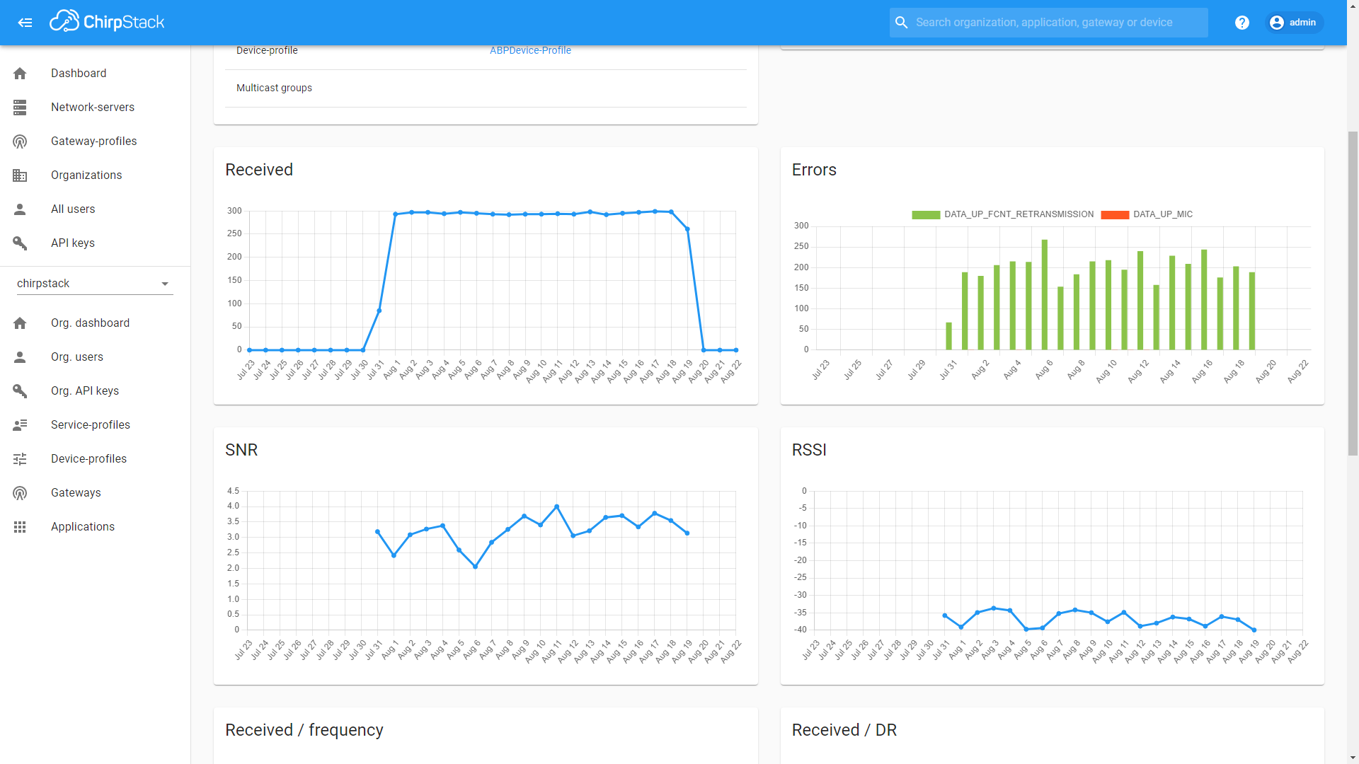

the picture above is state of a specific single sensor.
Although it communicates periodically with the gateway,
Only sensor data is not coming in.
I’d like to know the reason.

The problem I suspect now is a sensor or lora gateway setup problem.
It has a runtime of about 20 days. After 20 days, data from the sensor is not received by the LoRa Gateway server.
Whenever that happens, I delete and re-register the device from the chripstack management site.
However, it is too cumbersome to delete and re-register the device from the dashboard of the LoRa Gateway server every 20 days.
So I’d like to address the root cause.

I saw an article in the following link that said, “ABP stops working when the frame counter is exhausted.”
I am operating as ABP, and the DEVICE EUI, network session key and application session key are always fixed.
Maybe this is the problem?
