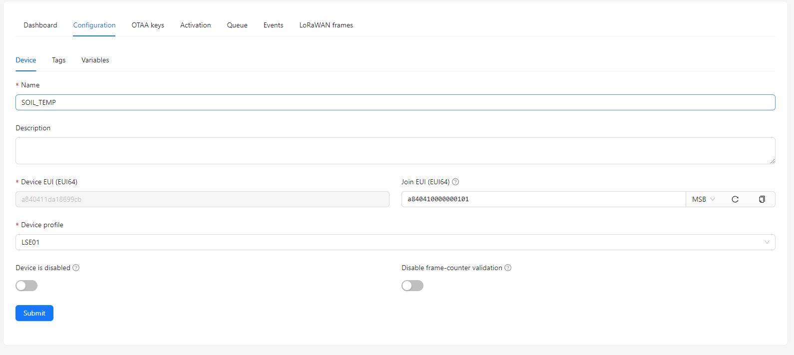

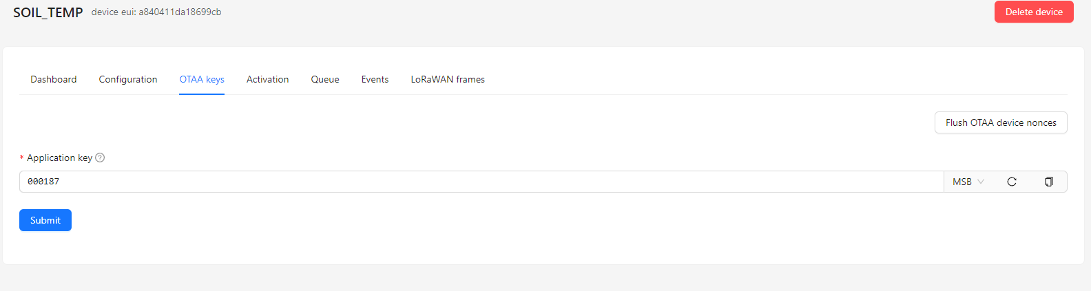

Context: I have a Dragino gateway and two Dragino sensors. When I connect them using OTAA on The Things Network (TTN), I have no problems and everything works correctly. However, I have been trying to integrate them into my local environment that runs ChirpStack, and this is where the problems arise.
Problem: I cannot get the sensors to connect to ChirpStack. I have rebuilt the platform on my server twice and validated the configuration multiple times without success. It seems that I am missing something, and I suspect it might be a minor but crucial detail. Additionally, I have many JoinRequest events, but I cannot show them because if I wait more than 30 seconds, the platform returns to the beginning with a 502 error.
