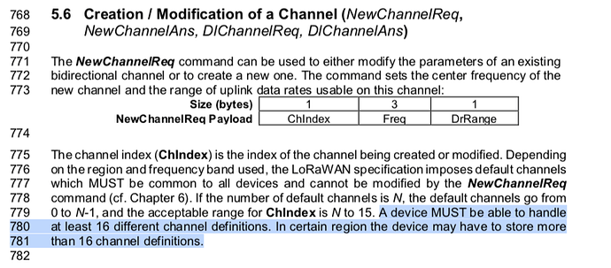

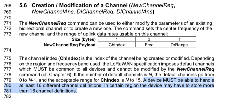

Following the LoRaWAN specification a device must be able to support at least 16 channels
You might want to confirm this with ELSYS or else ask if they can update their firmware :slight_smile:
