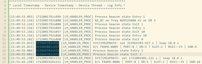

Hello forum,
I’m adding another piece of information.
I have an STM32WL nucleo board that simulate an end node. The firmware make use of LoRaWAN timesync to set the internal RTC.
The timesync is generally working fine. However, while the LNS is experiencing the “timestamp issue”, the device might receive a completely wrong timestamp:
As you can see in this log, the timesync at line 12 reports timestamp 315964783.928 (unix epoch) that roughly corresponds to January 6th 1980 00:00. The timesync is repeated at line 16, this time with a valid timestamp.
What’s going on? This kind of behaviour is catastrophic since I need to implement acquisition of timestamped events.
Is there anyone that can help on this topic?
