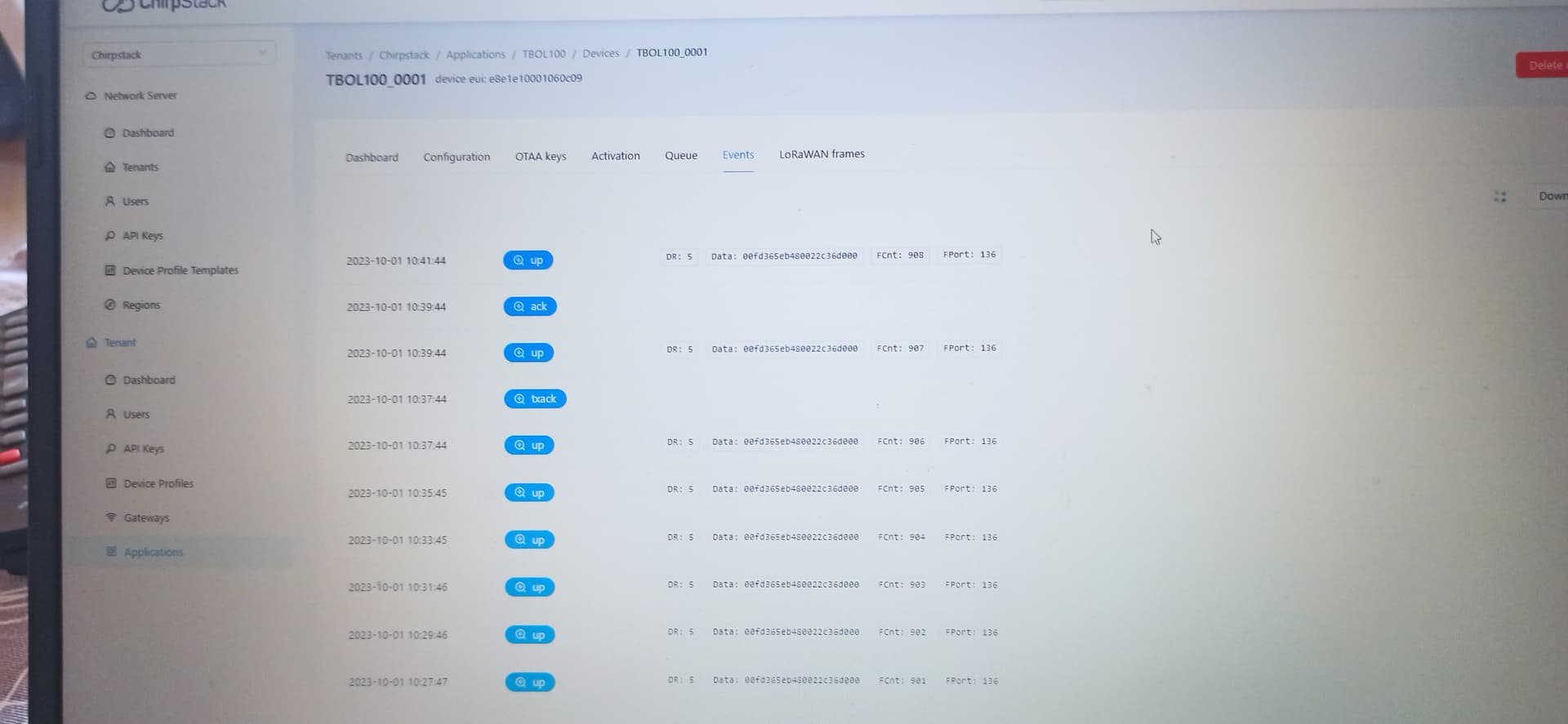

Somehow, the TxAck seemed to have come quite late. Have you checked the TxAck for the outcome of the transmission?

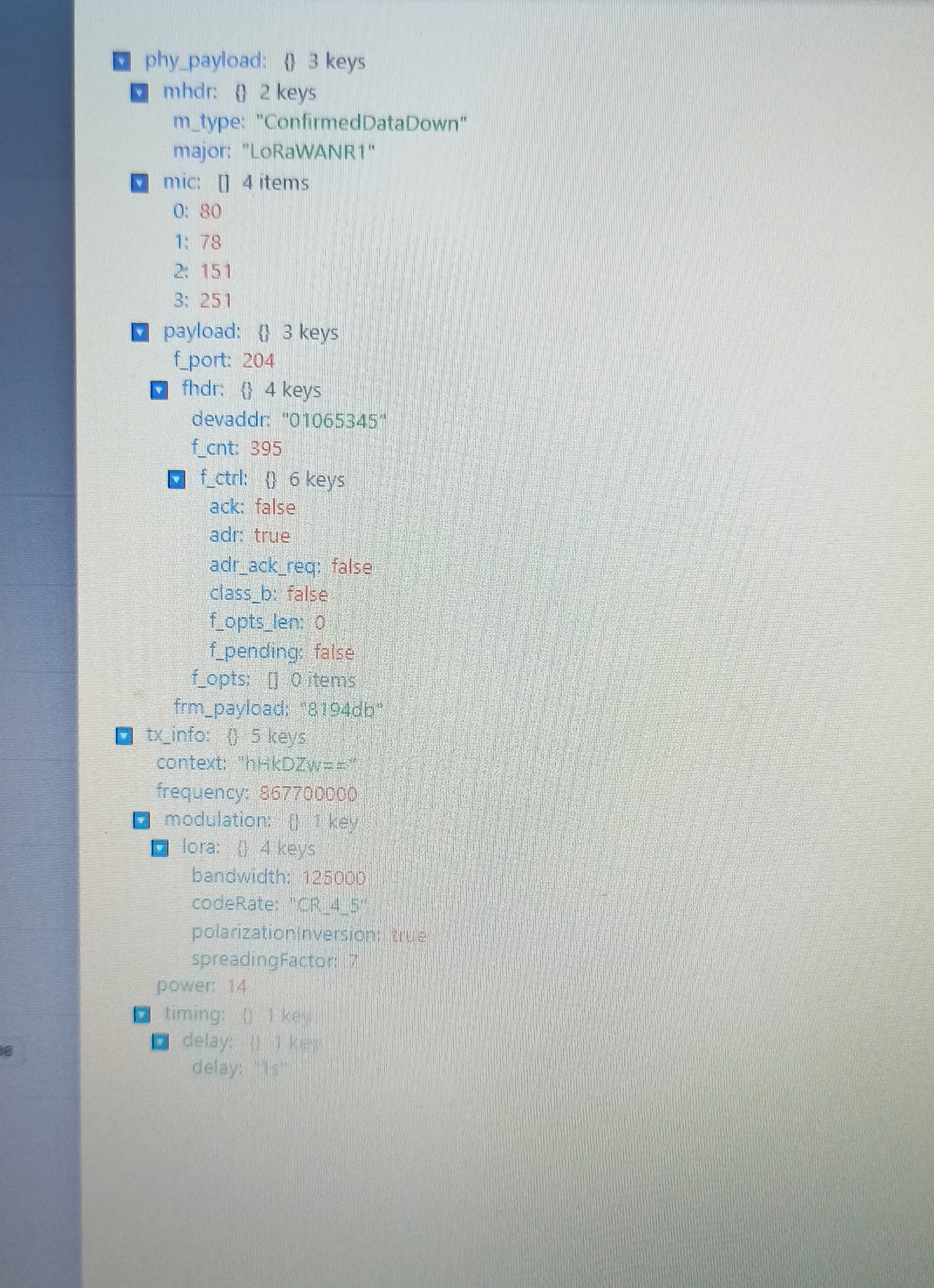

What I did was to translate hex 01201C in base64, on port 204 for confirmed downlink as written in the manual and then publish the mqtt …command/down topic. Same I did for the chirpstack UI and after the first uplink I see the ack and after some minutes I see the txack.
Below Txack is how it’s looks like:

“Ack” is meant to contain the outcome of the confirmed downlink. The screenshot of the contents of the “Ack” message, indicates that the device did not acknowledge a confirmed downlink. There is an uplink after TxAck. Since the Ack event indicates that the confirmed downlink was not acknowledged, it implies that the device did not receive the downlink.
From what you described, it does sound like you are doing it correctly. But something is not working as expected.
If the device is class A, it means that the transmission needs to take place 1s after an uplink. But in your screenshot, the “TxAck” appears 3s after the uplink. Now to think about it, perhaps Chirpstack had sent MAC commands before the downlink was sent, which were responded to by the device. Thus you wouldn’t see the downlink and the subsequent uplink, which would have triggered the ability to send thay downlink at 02:31.57.
“TxAck” may optionally contain an error, if the message could not be transmitted, but your later screenshot doss not show such a thing.

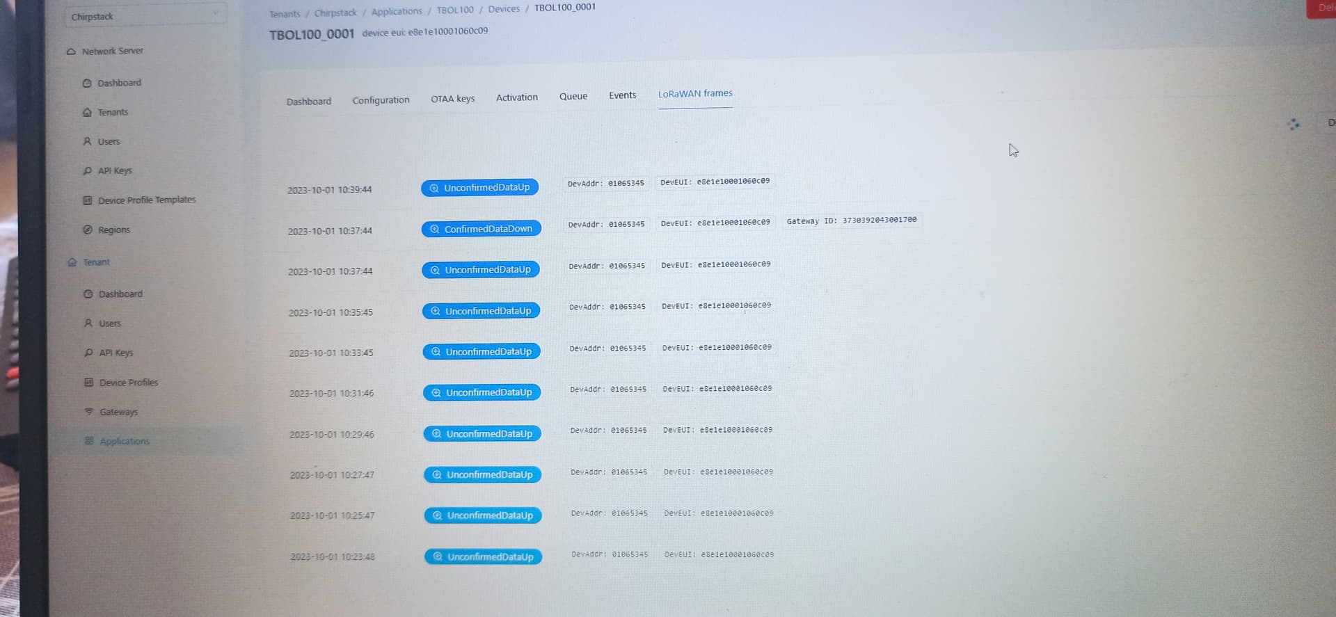

I feel that you should also study the LoRaWAN Frames window, not events. The Events list can only show you data that is relevant to the application, but this will exclude messages that contain only MAC commands. Those missing messages would help explain why the downlinks were sent at those times.
I did a downlink again.
Some pictures:
I don’t know if I’m wrong, now it looks like up and txack don’t have 3 secs delay.
