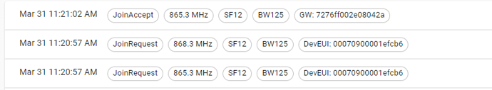

I receive every day “validate dev-nonce error” and I tried clear data etc… but nothing, now I saw I receive the follow events:
  1. JoinRequest with devonce XXX
    2 JoinRequest with devonce XXX
  2. JoinAccept
  3. error validate dev-nonce error
Someone have idea where is the problem?

I done three time in 3 days, now I saw arrive 2 Join Request and the second Join Request invalid the activation

I have other 200 same devices connected and I don’t think the problem is on key or LSB/MSB because when it sent JoinAccept i see on chirpstack the actvation tab full.
How far is this device from the gateway?
Seeing two join requests at perhaps the same time on two different frequencies suggests that your end device may be so close to the gateway (in the same room or even on the same bench) that it is overloading the receiver and appearing as a phantom signal on channels additional to the one it is actually transmitted on. If you look at the rxInfo, likely you’ll see the true signal is astoundingly strong with an RSSI of say -40 while the phantom signals are below -100.

That’s odd.
Can you post the rxInfo of a pair of these “duplicate” join requests? It’s important to be able to see all of frequency, and for the same gateway RSSI and microsecond timestamp.

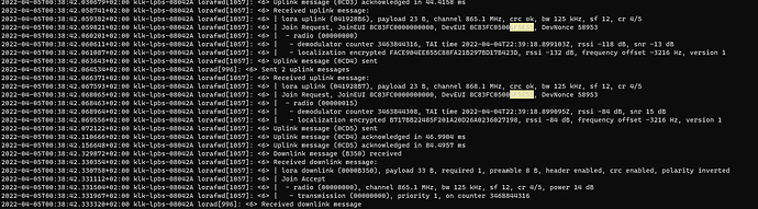

Sorry for the delay, this appears from the gateway logs.
2 Requests
1 Sent
Your gateway is reporting two identical uplinks on different frequencies only 8 microseconds apart in end time, which is fundamentally impossible for a single device.
You are suffering from corruption in the RF / signal processing, something that’s typically seen when strong signals drive a stage into non-linear compression, but probably due to a different cause here.
What is odd is that the stronger signal in this instance is only -84 RSSI.
I suspect something is wrong with your gateway, possibly a missing I or Q yielding to imaging around the IF’s center or a bit that’s somehow stuck leading to non-linear behavior even at reasonable signal levels.
It is theoretically possible that the issue could be on the transmit side, either in the baseband and upconversion or possibly an insufficient power supply to the node’s radio, such that it’s actually emitting signal-like energy on two frequencies.
Either way this is a hardware or at most operating environment problem, not apparently a software or protocol one.
