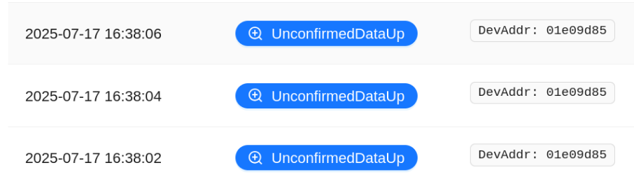

I work in a lab where we use a fair number of LoRa nodes with various Chirpstack instances. Today I noticed that one instance (running 4.10.2) was receiving a lot of repeated packets:
Indeed, these packets all had the exact same payload and frame count - the only difference was that the frequencies were slightly different. (We use US915, so they were something like 9039…, 9045…, 9053…).
Usually, Chirpstack knows to de-duplicate these packets, but in this case it did not. Digging into the logs, I found the (probable) reason why: (logging set to DEBUG here)

2025-07-17T20:38:02.191450Z  INFO up{deduplication_id=231c7edb-8805-4eb8-860e-4d9a74b02e07}:data_up: chirpstack::uplink::data: No device-session exists for dev_addr dev_addr=01e09d85

Hi there :wave:,
Many reasons can explain the problem, but it is difficult to say without knowing your context.
You mentioned “multiple Chirpstack instances”, so we can imagine a scenario where your device was provisioned on an instance A. The join was done, and the session infos are stored in instance A. For any reason, you moved the device from instance A to instance B. So on instance B, ChirpStack “knows” your device, but don’t have the session info.
Thanks for replying! It turned out that this was an issue of me being silly; I was chasing after a duplication bug that ended up looking a lot like this:
The issue was fixed by this PR allowing use of older Redis versions:
